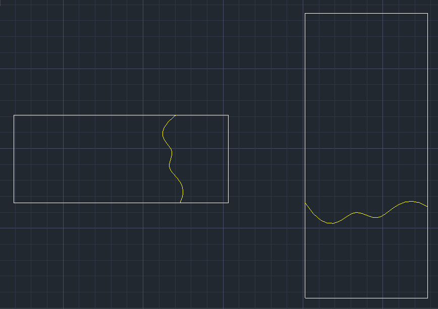

This tool simplifies the process of drawing Break Lines (Splines) commonly used in partial sections or detail views on a drawing.
  • Auto-Spline: Generates a natural-looking spline curve to represent the break line between two selected points.
  • Smart Snap: Automatically enables the Nearest Osnap to help you connect the line to existing geometry, and temporarily toggles Ortho mode as needed during the operation.
  1. Type PADAN in the command line and press Enter.
  2. Select the First Point (start of the break line).
  3. Select the Second Point (end of the break line).
  4. A spline curve (break line) is automatically drawn between the two points.
