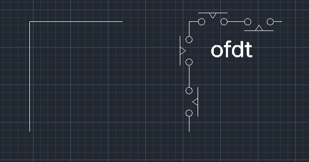

2/ Description : This tool automatically draws an Off-Delay Timer A-Contact symbol (Normally Open with Off-Delay) on a line, commonly used in electrical sequence drawings.
  • Sequence Context: This tool is part of the electrical symbol series and requires you to select a point along the line to determine the direction.
  • Symbol Scaling: On the first run, you set the insertion scale (e.g., input 1 for a 3mm circle diameter). You can adjust this later using the FAC command.
  1. Type OFDT in the command line and press Enter.
  2. (First Run Only) Enter the Symbol Insertion Scale (e.g., 1 for 3mm).
  3. Select the Line where the symbol will be inserted.
  4. Click a point along the line to define the Direction (Up/Down or Left/Right).
  5. The Off-Delay Timer A-Contact symbol is automatically drawn at the selected location.
