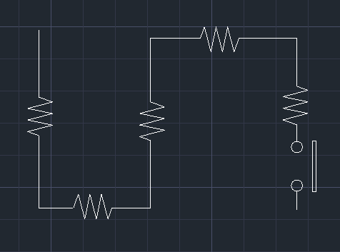

2/ Description : This tool automatically draws a resistor symbol on a line, commonly used in electrical and fire protection sequence drawings.
  • Function: It simplifies the placement of resistor symbols by aligning them to an existing line.
  • Symbol Scaling: Similar to other sequence symbol tools (like FUSE), you can adjust the size of the symbol using the FAC command. The base size (Factor 1) corresponds to a circular diameter of approximately 3mm in other symbols.
  1. Type JH in the command line and press Enter.
  2. Select the Line where the resistor will be placed.
  3. Click a point to define the Direction (along the line).
  4. The resistor symbol is automatically drawn.
  5. To change the size: If the symbol is too small or large, type fac and press Enter, then input a new scale factor (e.g., 2 for double size).
