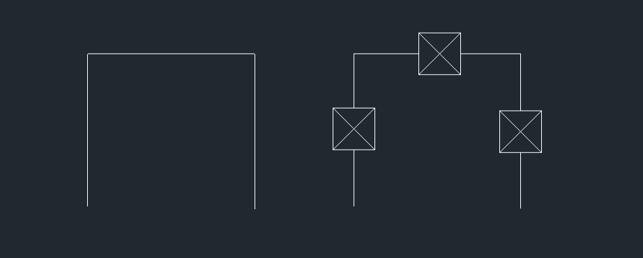

This tool allows you to insert a Pull Box symbol directly onto a line, typically used in electrical sequence drawings.
  • Symbol Scale: When executed for the first time, the tool prompts for an electrical symbol insertion scale. At a scale of 1, the box width is 8mm.
  • Scale Adjustment: You can adjust the symbol scale at any time during the command by typing the sub-command FAC.
  1. Type pbox in the command line and press Enter.
  2. Initial Setup (First Run): If prompted, enter the desired Insertion Scale for the electrical symbol.
  3. Select the Line where you want to insert the pull box. The symbol is automatically drawn at that location.
  4. To Change Scale:
    • Type fac and press Enter.
    • Input the new Scale Value.
    • Continue selecting lines to insert boxes at the new scale.
