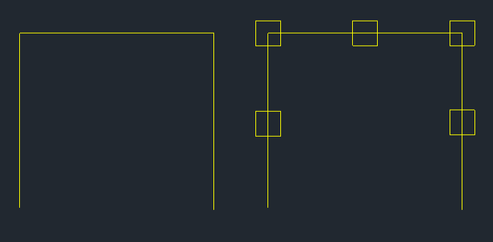

This tool allows you to insert a branch device symbol (often used for switches or splitters) directly onto a line in sequence drawings.
  • Symbol Scale: Upon the first execution, it prompts for an electrical symbol insertion scale. At a scale of 1, the box width is 8mm.
  • Scale Adjustment: You can adjust the symbol scale during the command by typing the sub-command FAC.
  1. Type bgg in the command line and press Enter.
  2. Initial Setup (First Run): If prompted, enter the desired Insertion Scale for the electrical symbol.
  3. Select the Line where you want to insert the branch device. The symbol is automatically drawn at that location.
  4. To Change Scale:
    • Type fac and press Enter.
    • Input the new Scale Value.
    • Continue selecting lines to insert symbols at the new scale.
