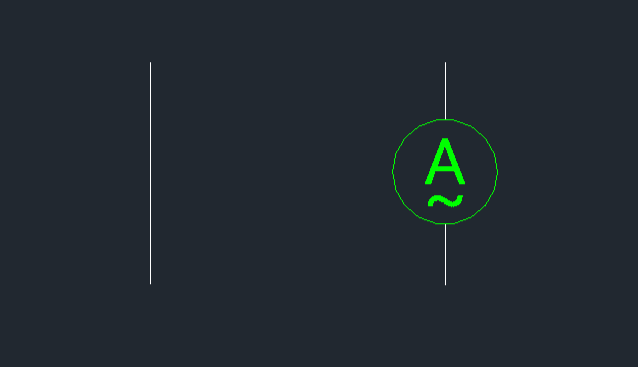

This tool automatically draws an AC current meter (ammeter) symbol at a specified location on a sequence drawing.
  • Standard Size: At an insertion scale of 1, the symbol's circle has a diameter of 21mm.
  • Dynamic Adjustment: The symbol's scale can be adjusted during the command using the fac option.
  1. Type acur in the command line and press Enter.
  2. Enter the Insertion Scale (required only on first run; default 1 = 21mm circle).
  3. Click the Center Point on the line where you want the meter drawn.
  4. (Optional) Type fac and press Enter to change the scale if needed.
  5. The AC current meter symbol is drawn centered on the selected point.
