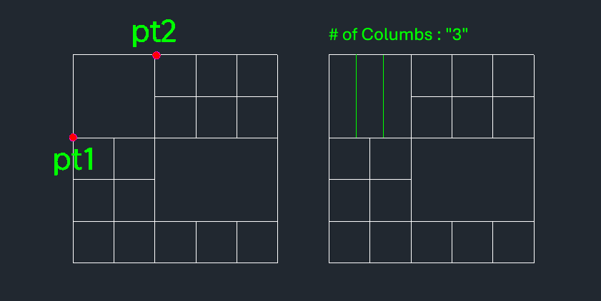

This tool vertically divides a selected table cell or horizontal range into multiple equal columns.
  • Input: Requires selecting the left and right points (PT1, PT2) of the area to be divided.
  • Flexibility: You can specify the exact number of vertical divisions (columns) to create within the selected space.
  1. Type splitv in the command line and press Enter.
  2. Click the Left Point (PT1) of the cell or range.
  3. Click the Right Point (PT2) of the cell or range.
  4. Enter the desired Number of Divisions (how many columns to split it into).
  5. Press Enter to complete the operation.
