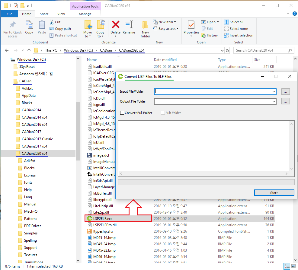

How to convert LSP file to ELF file ?
You can convert LSP to ELF file using LSP2ELF.exe file in 'C:\CADian\CADian2020 x64'.
※ What is ELF file ?
- It's usually used to protect for LISP source code.
