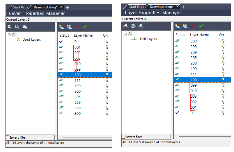

1. CADian version in use : 2025 Pro
2. Applications in use : Layer
3. Content : All my layers are in numbers. I cannot sort the layers in numerical order.
Dear Yrkim1219,
We apologize for the delayed response and any inconvenience this may have caused.
Regarding your inquiry, we have confirmed that CADian sorts layer names strictly based on string order.
Therefore, we kindly ask for your understanding and request that you add '0' or ‘00’ as shown in the attached image to achieve the desired sorting.
